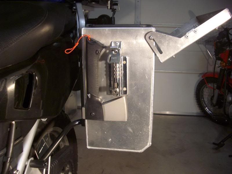

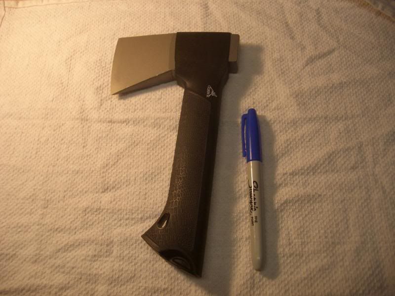

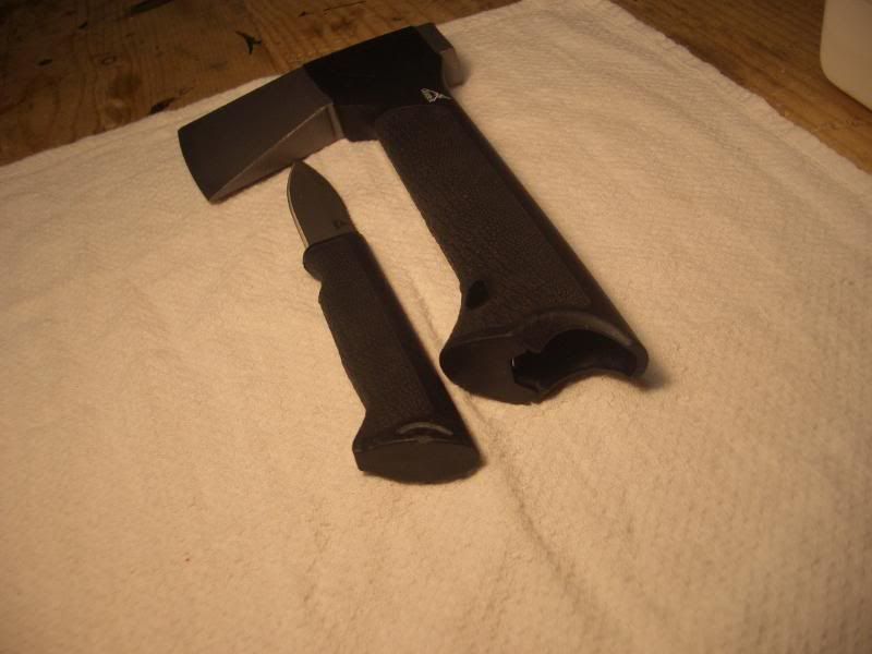

Enclosed is a review and mounting walkthru of the Gerber Gater Combo Axe, Model # GB-49470. It can be seen
here:http://www.knivesplus.com/gerber-gator-axe-gb-49470.html for $29.97.

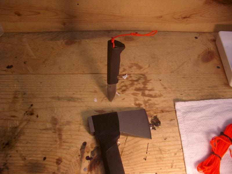

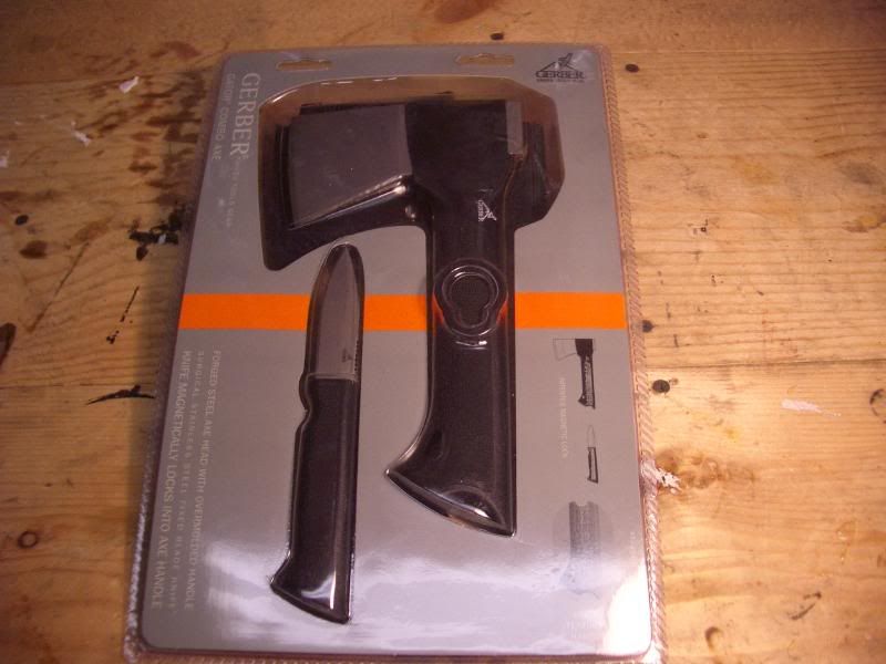

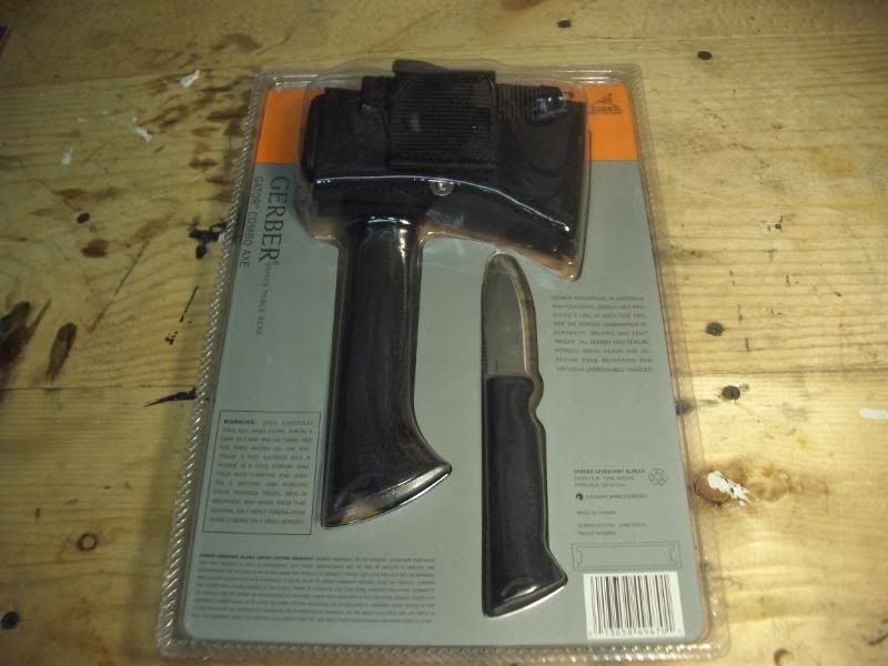

Axe in packaging...Includes a knife stowed in handle
opposite side of package
axe with knife out.
..It is magnetically connected to handle...so it will not fall out

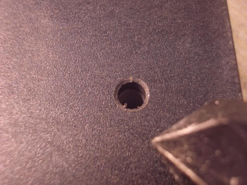

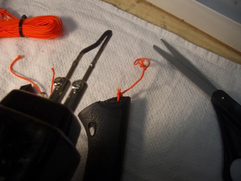

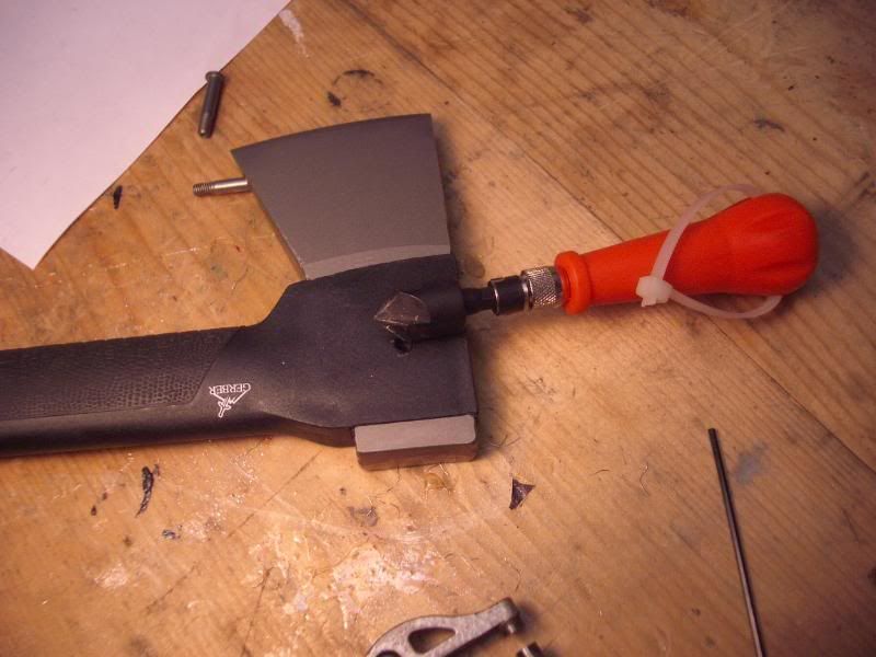

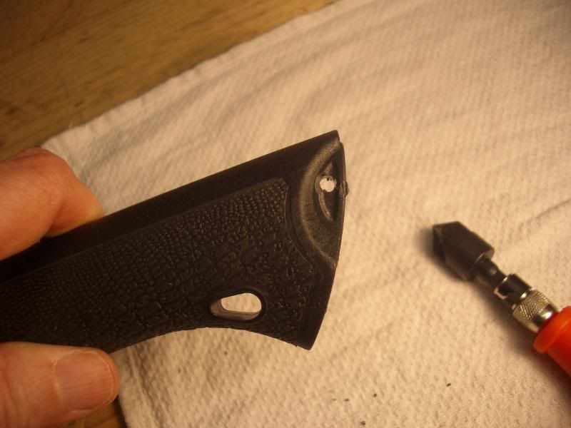

drill hole in knife handle to attach a lanyard
de-burr hole
attach lanyard, cauterize end of string
like so

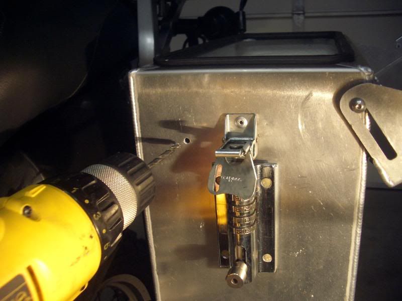

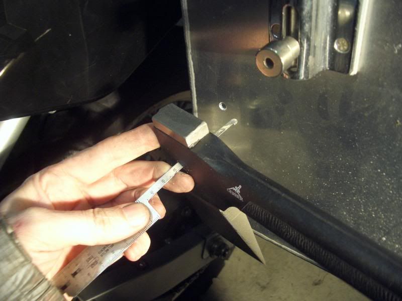

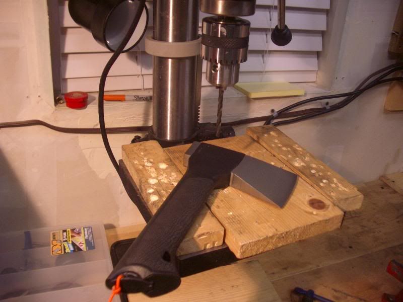

drill thru axe head. Stainless steel by the way
lot’s of chips
de-burr holes
for polished look

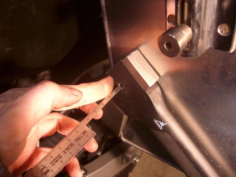

pannier attach hole

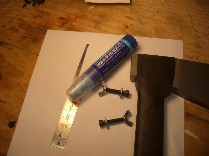

check grip length of fastener
using this tool

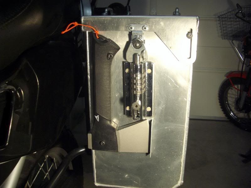

goto fastener bin, using hex head and wing nuts for easy removal, yet tamper proof

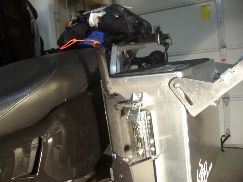

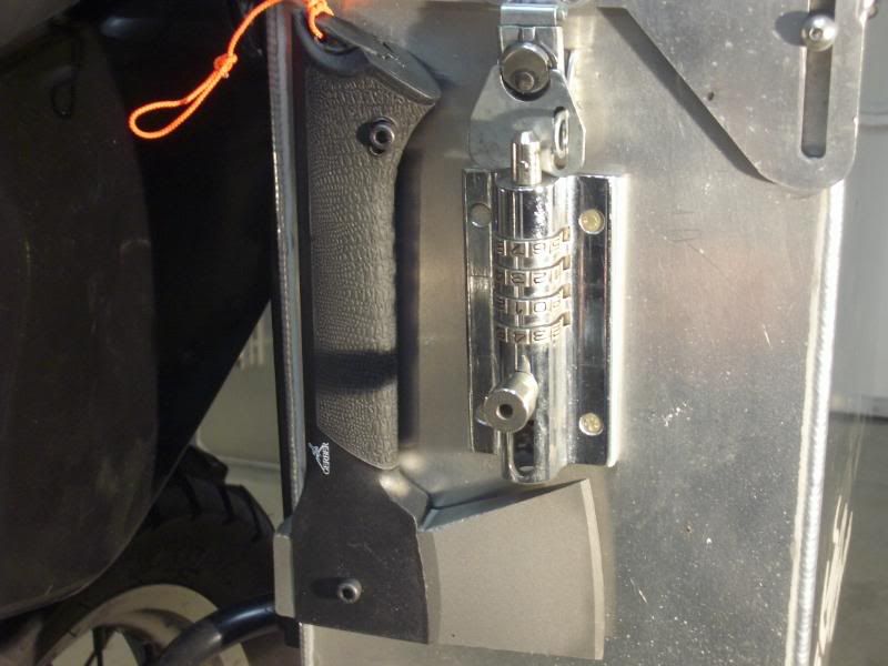

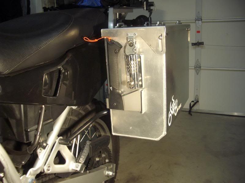

as attached
closeup of 2x attach fasteners
inside view.. See wing nuts..I also coated the panniers with white bed liner material...no regrets to that mod

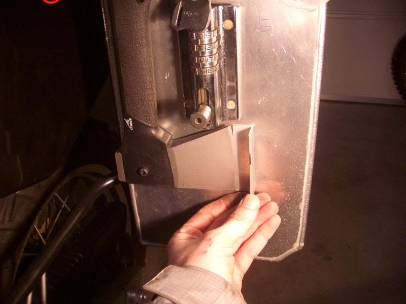

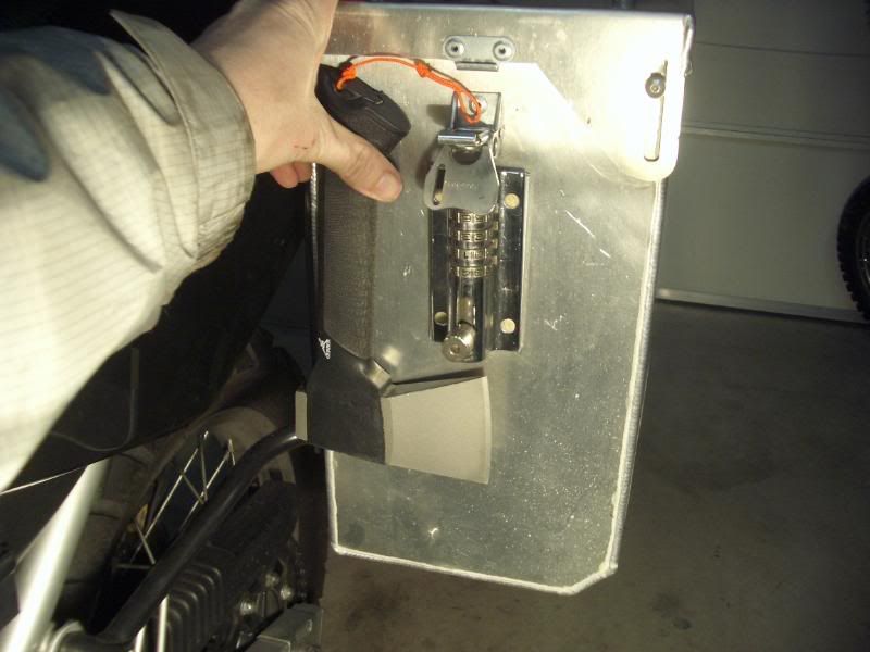

need to add a blade guard about here
prep for install
guard as installed
can access the knife only with lid up...no one can swipe the knife
all locked up with keyless lock system...Great mod also
Standoff view
Review:
1. Nice to have an axe for long distance travels
2. Can be used as a hammer
3. No axe metal contacts the panniers
4. Not really cut anything with the axe, but blade is sharp and seems to be well balanced for light duty work
5. Knife in handle may come in handy
6. Can still take a passenger, as the mount does not interfere with 2 up riding
