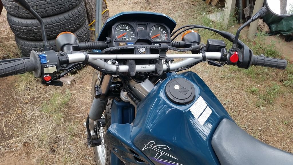

The bike currently! runs great but still have a couple things i want to do :)
finished" border="0
finished2" border="0
