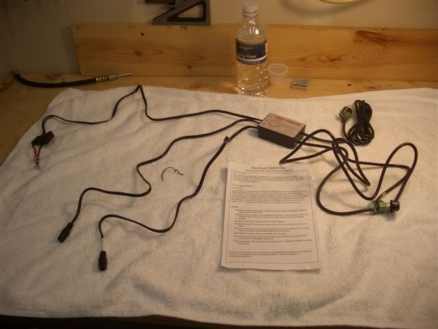

Enclosed is a review of my warm-n-safe heat troller install on a KLR650. The troller will be used to heat both my liner and gloves independently. The troller works by full power alternating on/off on cycles. So at ½ knob position, the power goes on full for 1 sec and entirely off for the next sec.  The troller is the seen here:
http://www.warmnsafe.com/motorcycle_product_TOC.php
troller as delivered.

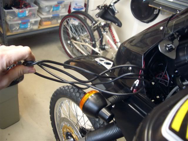

rats nest of wires that don’t suit the KLR layout well. There are 4x items to mount/attach wire. First mount that box in the middle of the view, about the size of an Altoid container.

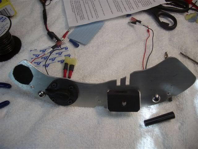

attach with heavy duty velcro
peel and stick to box

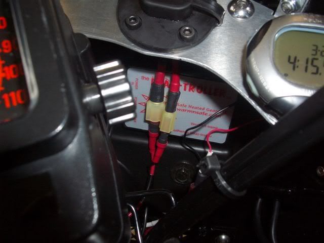

attach box under dash
open up the area for wire attach

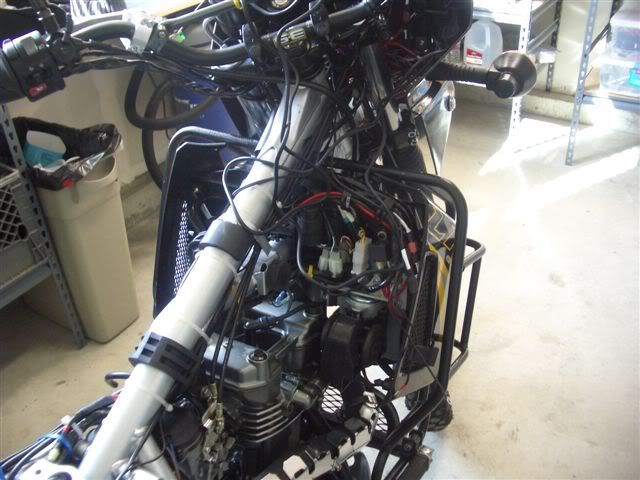

Item 2- power from battery to relay, activate with city light leads, connect troller power to relay. Wires were long enough to reach the horn area, not the battery. Details have been shown in the Stebel horn “how to”
Like so, #2 done

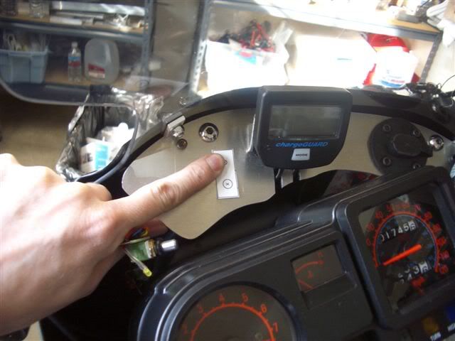

mount these little knobs on the dash
instructions came with template, wires were real long, need to zip tie out of way
mark location
remove dash
attach knob

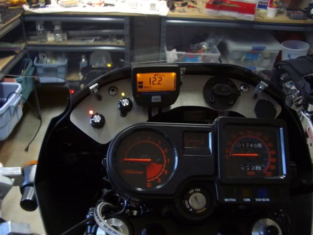

extra wires to zip tie under dash
knobs installed on dash

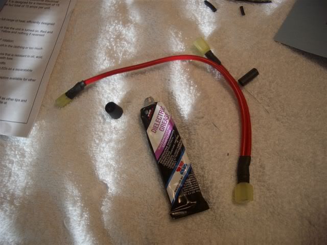

the coaxial plug for was not long enough to reach the base of tank, so I spliced in a 18 gage line
soldered this one
reaches tank area, zip tie along bike spine
exposed connectors. One for gloves, other for liner. However, both connect to liner
finished dash
