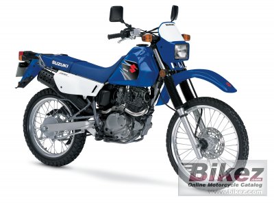

Looks a lot like a DR 200 tank. DR 200 capacity listed at 3.43 gal/ 13 litres.

> Mel Brooks
It is right!
It is exchanged for a large-sized headlight and the model is sold as "DJEBEL200" in Japan.
